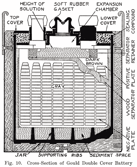

Good Job. Batteries that bounce around fail sooner, as the material cracks/flakes off the plates, falls down to the bottom of the case and eventually piles up high enough to short across the cells. Back in olden times, battery manufacturers left more room below the plates for this material to fill up, but with underhood space at a premium now, this is one area that has been compromised in order to get more cold cranking amps / amp hours in a smaller package.
